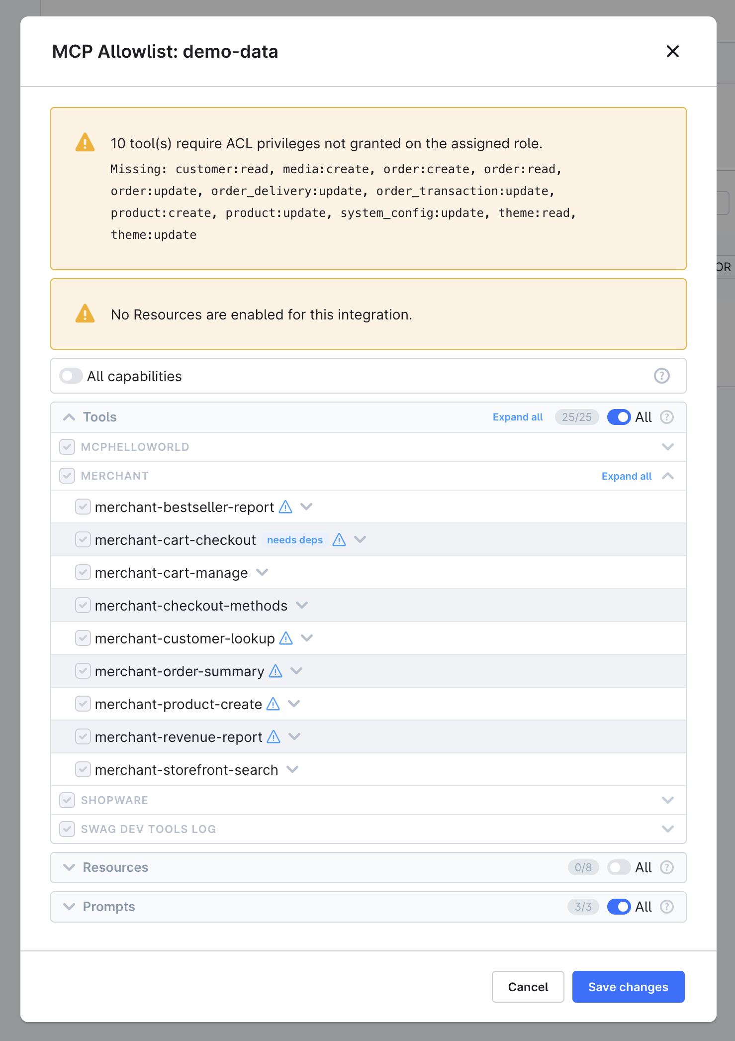

Limit tool count
Each tool added to the MCP server increases the context window consumed by tool descriptions. More tools mean more tokens spent before the agent even starts reasoning. Shopware core ships 11 built-in shopware-* tools, and plugins like SwagMcpMerchantAssistant add more, so keeping a single integration lean matters.
The practical approach is one integration per persona or job, each with a scoped tool allowlist. Not one integration gets everything. A persona is a specific role with a specific job; it only includes the tools that role actually needs. For example:
  • Merchant integration: order state, system config, media upload, theme config. What a store manager needs day-to-day.
  • Developer integration: entity search, entity schema, aggregate, system config read. What a developer or CI pipeline needs for inspection and debugging.
  • App-specific integration: only the tools relevant to a specific workflow or external system.
Each integration sees only its allowed tools, resources, and prompts, so each AI session starts with a smaller, more focused context. Treat the allowlist, system prompt, and exposed resources together as product quality, not just security. A narrow context makes the agent reliable; a broad allowlist dilutes routing and degrades answers. Configure allowlists under Settings → Integrations → Edit MCP Allowlist (per integration) and Settings → Users & Permissions → [user] → MCP Tool Allowlist (per user).
Every registered tool also consumes tokens from the agent's context window throughout the session — not just when it's called. Each tool schema (name, description, parameters) costs roughly 550–1,400 tokens depending on complexity. Some clients enforce their own hard caps (Cursor limits the total to 40 tools across all connected MCP servers). Scoped integrations with a small allowlist keep sessions fast and predictable.
When everything is enabled, the modal also shows inline privilege gaps, meaning the integration's role does not actually cover what its allowlist exposes:
Allowlist modal with all tools selected, showing inline privilege warnings
