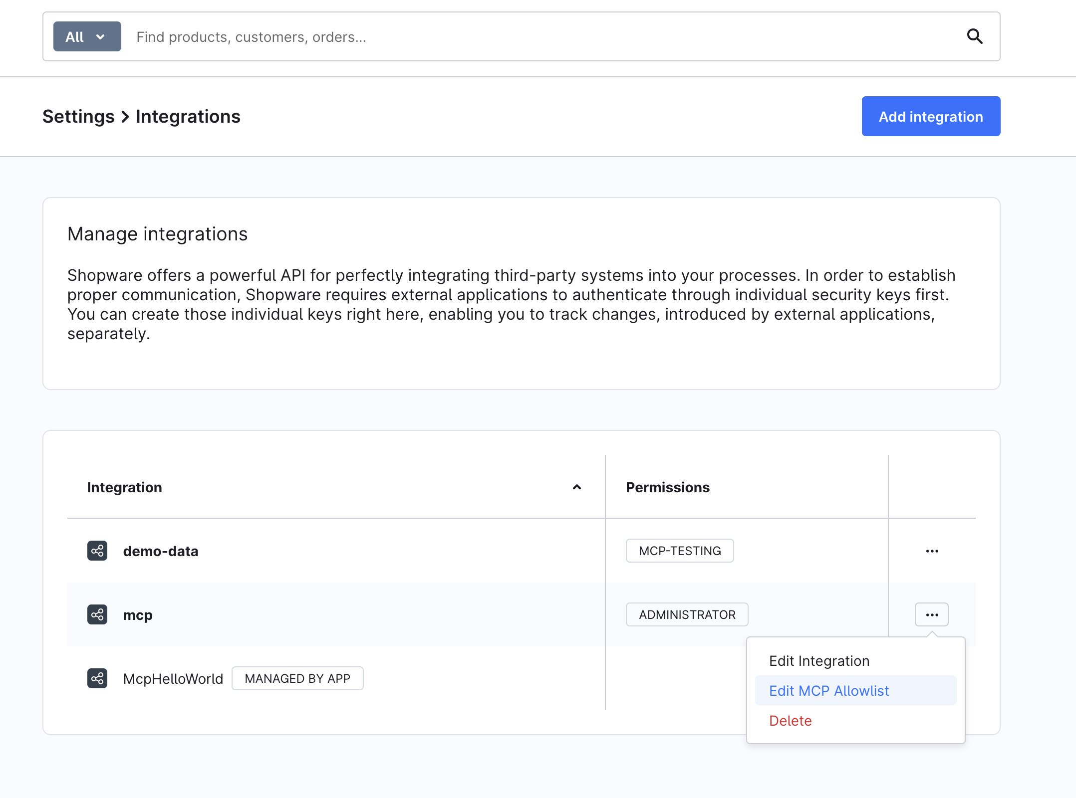

Per integration — Go to Settings → Integrations, open the context menu for your integration, and select Edit MCP Allowlist:
Edit MCP Allowlist action in the Integrations list

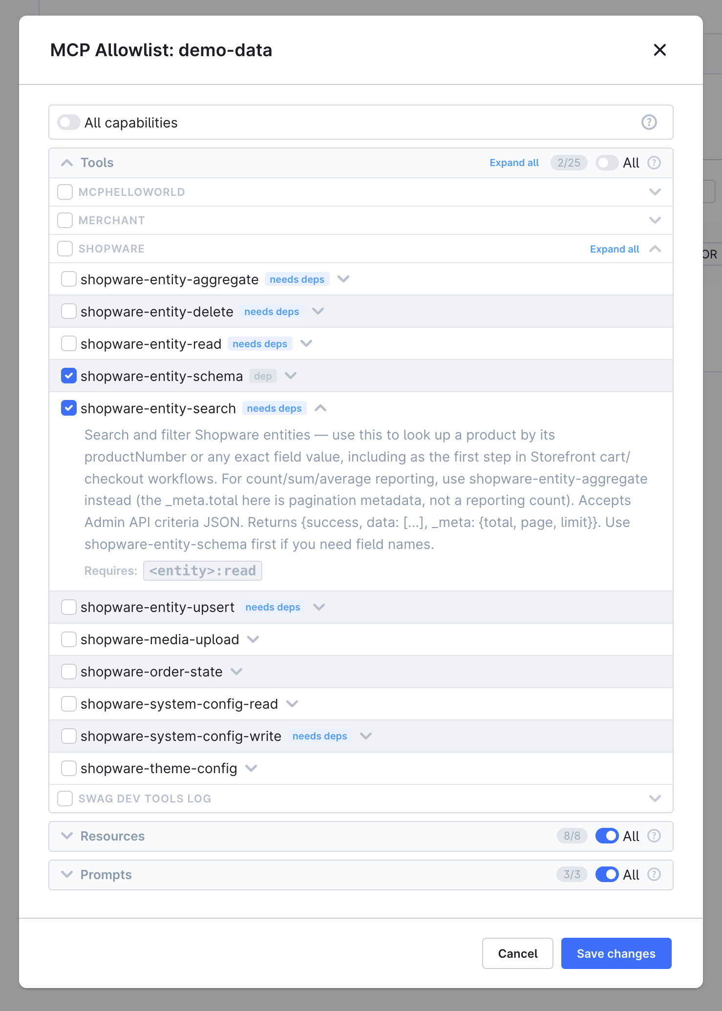

Disable the toggle for each capability type and select only the tools, resources, and prompts this integration should use:
Capability selection modal

When a tool is enabled, its declared dependencies are automatically included. For example, enabling shopware-entity-delete also enables shopware-entity-search and shopware-entity-schema because they are required for it to work.
